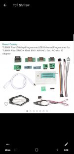

thank you and appreciate , but i don't have SVOD programer. i do have TL866II program where can i install it on main bios or EC bios ?
unfortunately i don't know about TL866II programmer
we use SVOD and Vertyanov programmers

Please ask your programmer support.
Thank you, but they informed me to identify GND,CS,CLK,MOSI and MISO pins from the keyboard jack to program the IO. could you send me the schematic diagram for dell inspiron 3521 (VAW00 la-9104p ver: 1.0 - a000)
