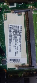

send motherboard model
search on motherboard under all stickers and heat sink
Nuclearpunch
it seems like it's the motherboard's referece ?
